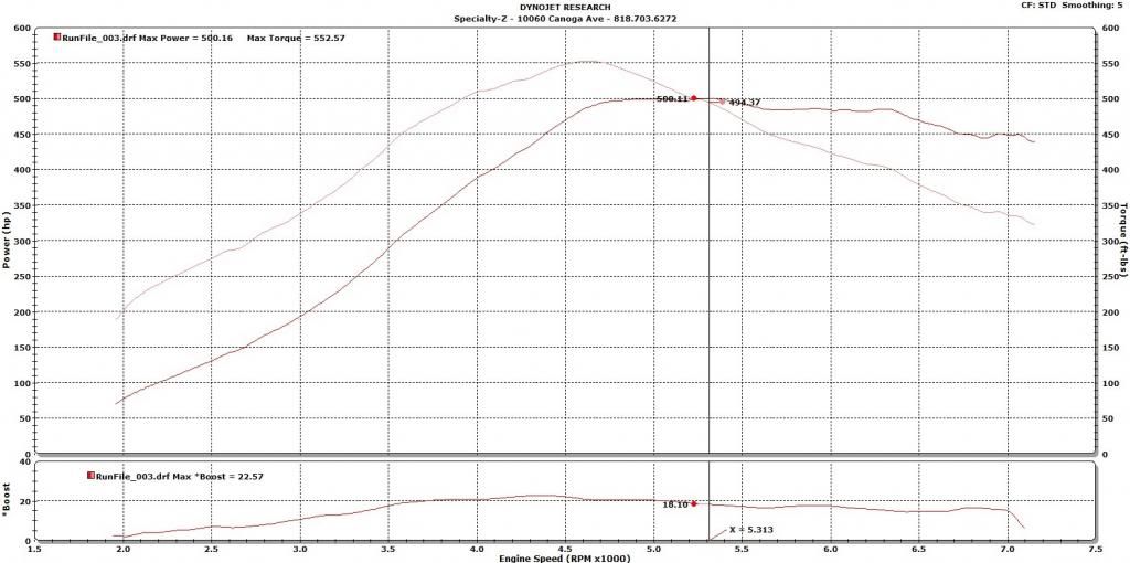

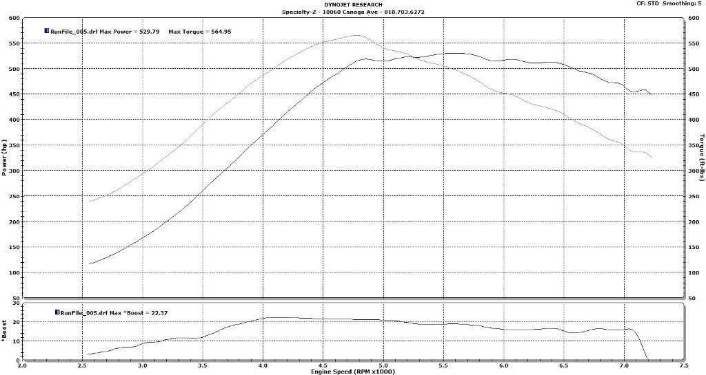

Message I've been looking at these SZ tuned stock turbo e85 cars for a while tonight. Very similar, but the first has MSPs and expansion outlet pipes. Part that confuses me is how the bottom car reaches full boost 500rpms earlier, with less breathers. The bottom car also reaches its max rwhp and torque at about the same as the top car, but gets The MSPs and outlets do squeeze out another 29rwhp in the long run for the top car, but surprisingly it makes the graph shift upward, not to the left like always thought. Can the .5 increase in exhaust that the bottom car is sporting throughout be the culprit? I'm still amazed that California cars sporting high flow cats can put down power like this.
